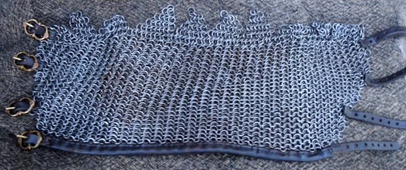

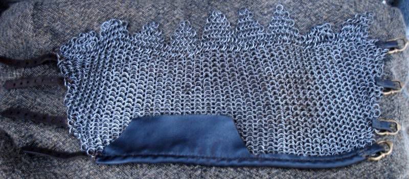

The constuction of these standards is relatively easy although, as Brendan has mentioned, it may be necessary to use inserts of mail if making a large standard capable of covering the shoulders. Here is a simple standard which I made myself some years ago:
The standard is buckled by four straps at the back and has a liner of calf-leather at the throat to lend comfort and form. Although the basic construction is essentially a simple rectangle of mail, each end is 'graduated' to allow a more comfortable fit. Small triangles of mail decorate the lower edge of the standard as was often depicted on contemporary illustrations including Durer's famous engraving of 1521.

My standard just took a few evenings to put together and was well worth the effort. Hope this helps.
