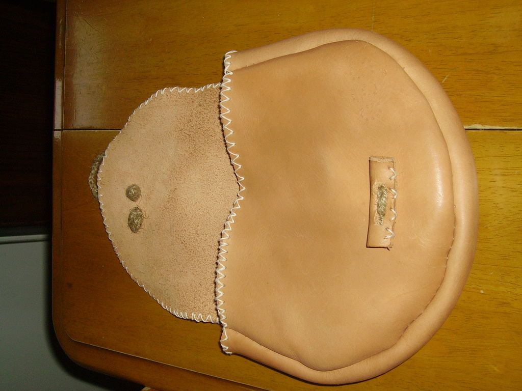

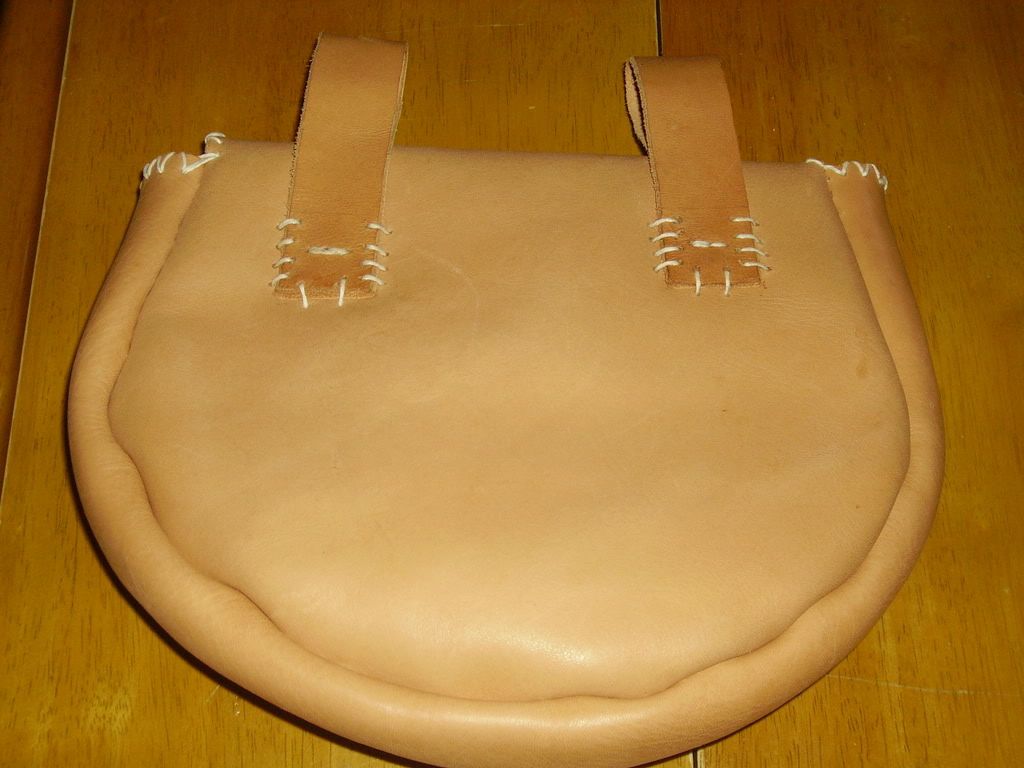

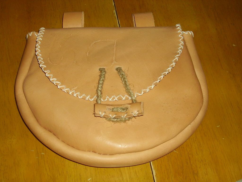

I got leatherworking tools a little under a year ago but ive only just been able to get some leather to work on so I thought I would have a go at making something. Its a viking pouch (I hope), it took about 10 hours from design to completion. I didnt have a pattern so I used 2 soup plates and a ruler and kind of made it up as I went along. I was wondering what people think about it as far as design flaws and authenticity goes. Their should be 3 pictures if Ive done this right.

looks ok to me - certainly a lot better than my first effort at a pouch!
A few questions:
~ you have eused blanket stitch on the edge. I think that it is a very late period stitch. A simple whip stitch would have worked just as well.
~ What is the cord/twine made from
~ is the thread linen or synthetic?
If you want to darken it then just leave it out in the sun for a bit - it will develop a natural sun tan (not kidding)
Brendan

I made up the stitching up as I went along always using 2 needles and the edging was a spur of the moment idea around 4 in the morning, I could change it for a whip stitch but I'll have to figure out how to do it first.
The cord is hemp twine I platted.
The threat is linen sealed with bees wax.
Im making another pouch with a different closing mechanism (a strip of leather down the centre going through a loop) I might try a different stitch on the edging of this one. Also I have had ideas on scababards for saxes and swords and a platted leather belt I might try to make. This time I will try to do work in progress photos aswell and post them up for advice.
